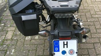

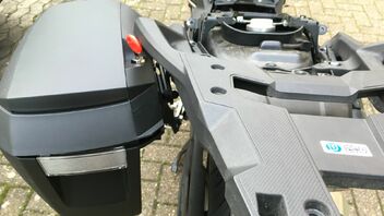

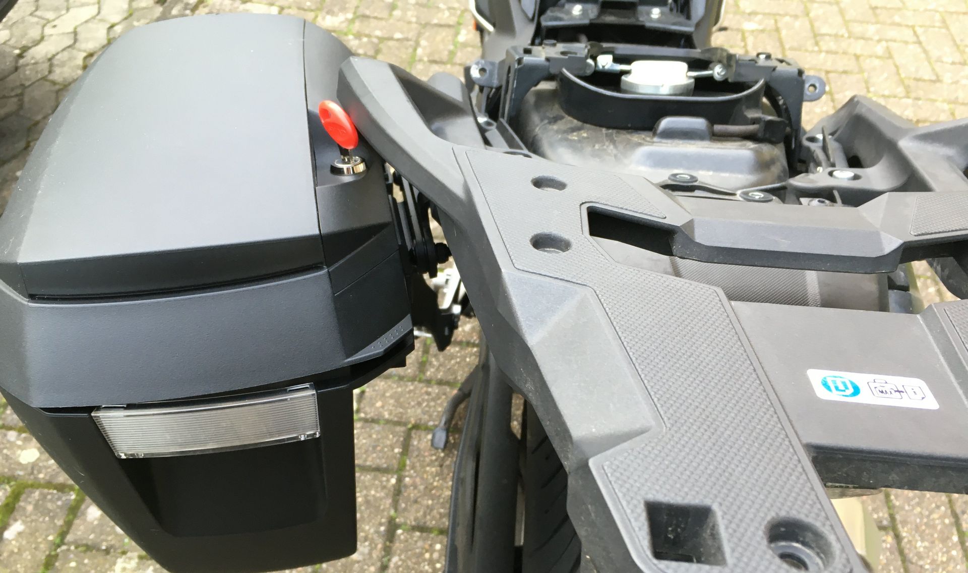

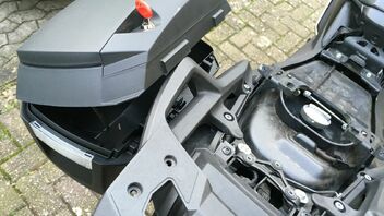

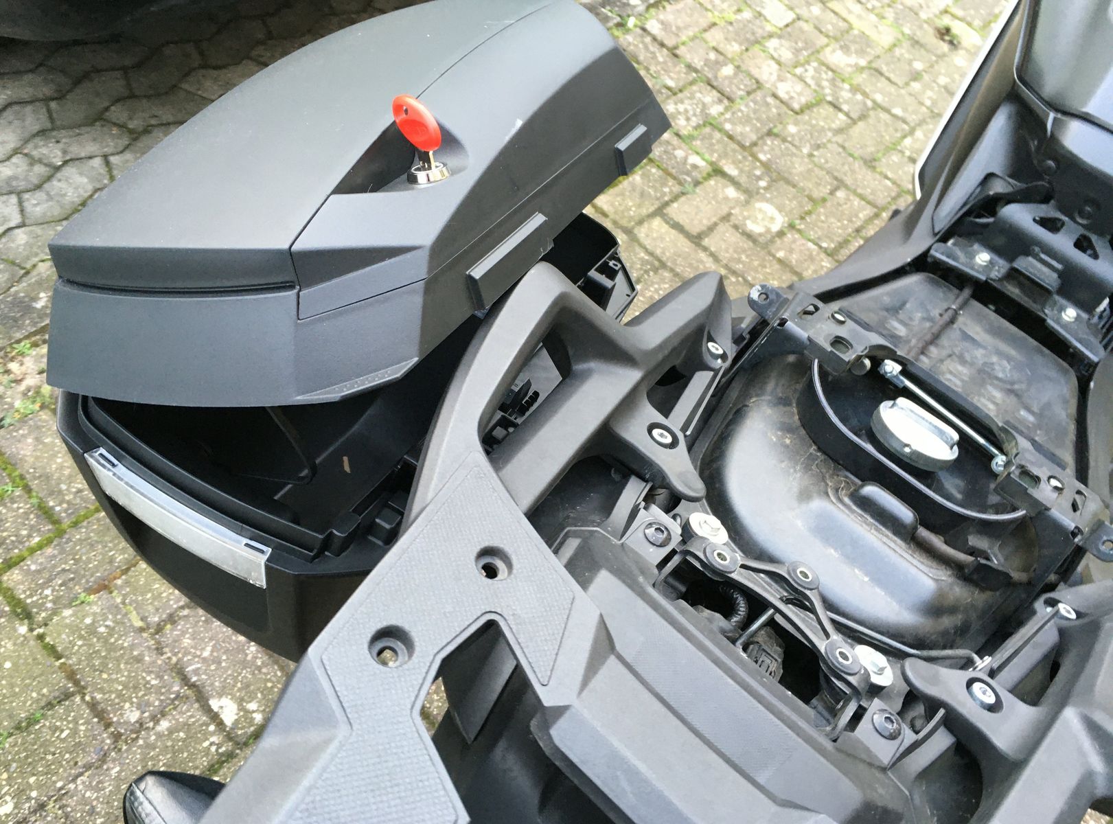

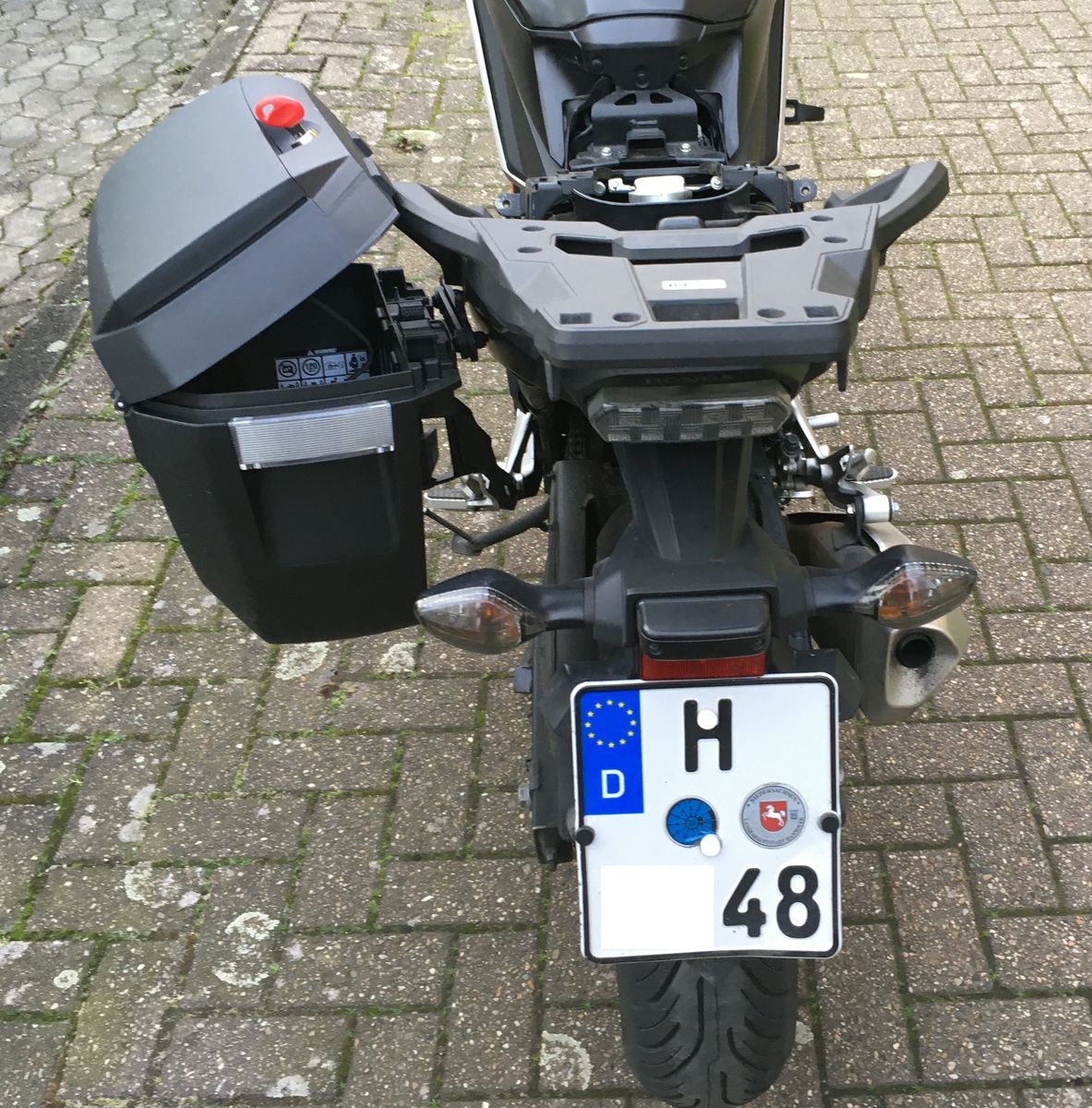

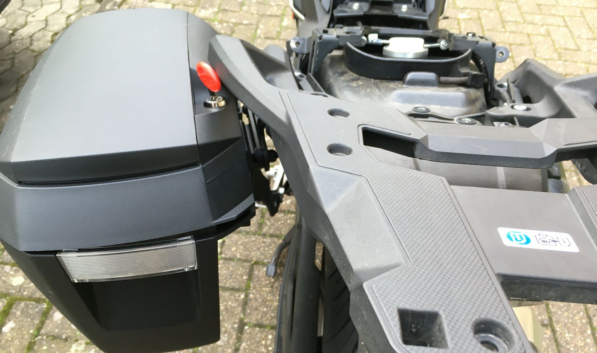

    Er will wissen, ob die Shad Seitenträger mit dem Originalgepäckträger von Honda kollidiert.
    ...und da hat er Recht. Ich entsinne mich an ein Foto, dass genau das Problem zeigt... aber... wo war das nur...?
    Wenn ich einmal GROß bin, heirate ich mein Motorrad...
    Thanks a lot but the cases in the photos are the SH23 that opens its top. The SH35 opens its side and doesn't create problems. The problems are with the 3P bar... Did you have problem with them? Bye, Luca.

    Here you can see how much distance I have with my RC90 and standard handles and the 3P-rack... My screws don't touch the plastic.
    Some people got the wrong mounting kit delivered. Doublecheck it, if it´s really the right mounting kit.15852-shad-halter-3p-an-16er-nc750x-autoscaled-jpg

    The problem is only at the hole ahead , la tua foto è il foro posteriore e la mia è perfetta.
    Quanto spazio hai alla buca davanti?
